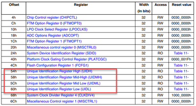

Dear NXP,
I am using S32K148. Is there any way to read the ID of this chip from the code?
Barry
タグ(1)
1 返信
1,345件の閲覧回数
VaneB
Hi @wang_q4
Please take a look to the chapter 11.3.1 SIM register descriptions of the S32K1xx Series Reference Manual, Rev. 13.
