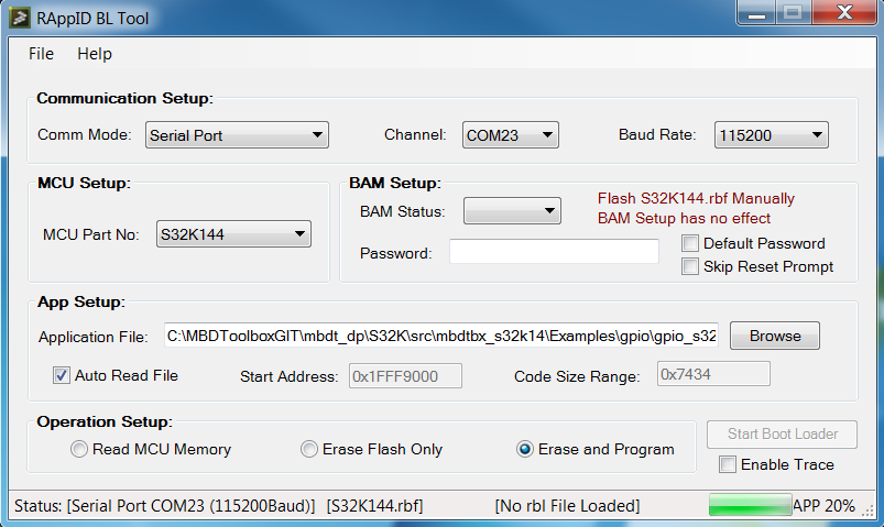

koehlerl
Hi Daniel,
I use the S32K144 EVB. I have flashed the rbf file first. But I can’t connect with the RappID BL tool.
The trace window of RappID BL Tool is empty an then after timeout the Error message comes:
There are different kinds of the rbf file for the s32K144 CPU?
BR Lutz

20,141 Views
Daniel_Popa
Hi Lutz,
There are different versions of RAppID_BL.exe and different versions of RBF files.
I'm using bootloader version 1.6.5.1
And the RBL attached and is working fine via the micro-usb
Here is a snapshot programming the S32K144EVB-Q100
Hope this helps!
