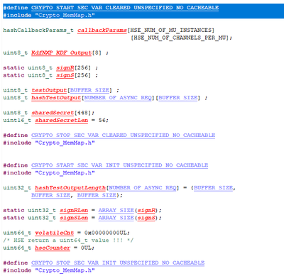

Now, we want to enable the DATA cache for the whole project so we try to force the data structure to non cacheable memory but without success.
We can't figure out which struct needed to be in non cachaeable memory and in which section add the strut ( .mcal_data_no_cacheable ? )
Does anyone have an working example ?

Hi @sobo
Any variable (hseSrvDescriptor, input/output length/size pointer , data pointer…) used in the interaction between the core and HSE need to be placed in a non-cacheable area (DTCM, non-cacheable SRAM…). You can take a look at Crypto examples in RTD. You will always see something like this - and that will do the job:

lukaszadrapa
Not all variables/structures are obviously forced to non-cacheable area. Could you share your code? Did you define the variables as shown on the screenshot above?
