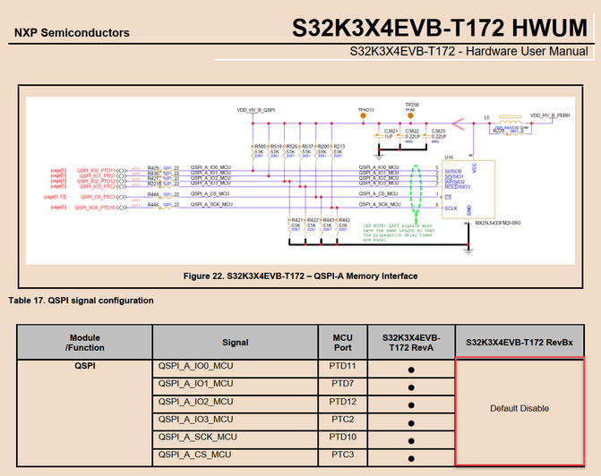

I am using S32K3X4EVB-T172 board. I working in QSPI example i.e. Qspi_Ip_Example_S32K344. But I am getting timeout status at erase block operation.
Please help me to resolve this issue.

1,221 次查看
davidtosenovjan
I have found similar problem described here
https://community.nxp.com/t5/S32K/S32K3-Qspi-s-bug-caused-a-timeout/m-p/1820345
but it seems it is only issue with other derivatives than 344.
Could you specify used S32DS, RTD versions, board revision and whether you used example code as it is?

I am using
1. S32DS: S32 Design Studio for S32 Platform 3.6.3
2. RTD:  6.0.0
3. Board revision :  SCH-53148 REV B2, 700-53148 REV X5
4. Yes I am using example code as it is.

I guess the issue will be here:
Although I am not sure what is actually disabled. I will check it tomorrow.

I can confirm the same behavior on my side. Until now I don't know the solution.
