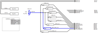

maria_beatrice_balaceanu
Hi, Nhi Nguyen,
Thank you! I have checked the "value" and "operation->size" fields and they seem to match the ones configured in QSPI_IP_OP_TYPE_RMW_REG (1_WriteReg_value.png and 2_WriteReg_size). I have also checked the values of the IPCR and TBDR registers after exiting Mem_43_ExFls_Init(). The values are in 3_RegistersVals.png.
Could the clock configuration have any influence on the way the data from these registers is transmitted? I have attached the clock configuration in 4_clock_conf.png and 5_clock_conf.png. Please note that, for 5_clock_conf, Design Studio does not allow me to modify the divider of QSPI_SFCK_CLK (marked with red).

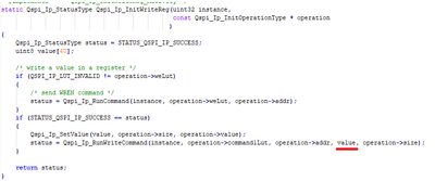

Nhi_Nguyen
Hi maria_beatrice_balaceanu,
Can you read value of this variable "value" that I highlighted in red in below picture:
This "value" will store value configured by the parameter "Bit-field value" in configuration. Then, data transferred into Tx buffer through the register TX Buffer Data Register(TBDR) and size of data determined in the register IP Configuration Register (IPCR). So, Can you please capture value of 2 these registers after you run over the function Mem_43_ExFls_Init()?

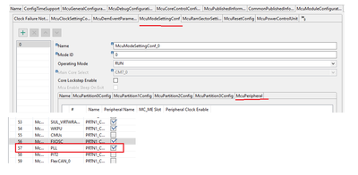

Nhi_Nguyen
Hi @maria_beatrice_balaceanu ,
At the moment, I don't have the board to check, but I looked at your configuration and I saw that you is missing this.
Because You're using Clock source from PLL but you didn't tick this parameter in SetMode, so, PLL clock wasn't gated after you run through the function Mcu_SetMode().
You can try to do this first, if it can't resolve the problem, I'll find the board to check.
Hi, Nhi Nguyen,
Thank you! I have enabled this setting, but the WRR instruction is still not sent correctly. Could this be caused by a misconfiguration of the PLL register?

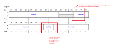

Thank you for your support! After our discussion, it seems that the most probable cause is a bug in the generated MCU driver, namely MUX_10_DC_0. We have requested a hotfix for this.
55,670 次查看
Hi, @Nhi_Nguyen ,
I have tried to modify manually the value which sets the MC_CGM/MUX_10_DC_0 to the same value as the one obtained with sys_init() (0x80020000) for PLL PHI1 at 240 MHz (1_DIV3.png), but the WRR instruction is still not sent correctly. I have also tried something similar with PLL PHI1 at 320 MHz, but still no luck.

Nhi_Nguyen
I've just realized that a part of divider of MUX_10_DC done default by HW, so, we don't need to plus it to MUX_10_DC_DIV. So, it is not bug in driver. So, can you please cancel request to hotfix.
Just follow RM with option A+ memory
In DS configuration:
Nhi_Nguyen_3-1686906398621.pngNhi_Nguyen_4-1686906407858.pngNhi_Nguyen_5-1686906418398.pngNhi_Nguyen_6-1686906426329.pngNhi_Nguyen_7-1686906435027.png
Nhi
Hi, @Nhi_Nguyen,
Thank you! I confirm that the WRR instruction is sent correctly with this configuration (RM 23.7.2.1 with Option A+). We have cancelled the hotfix request.
I have also tried to decrease the frequencies of the CORE_CLK and CM7_CORE_CLK clocks, while keeping the other frequencies the same as in RM 23.7.2.1 with Option A+, but then the WRR instruction is no longer sent correctly. Is RM 23.7.2.1 with Option A+ the only clock configuration for which the QSPI_IP_OP_TYPE_WRITE_REG operation sends the correct data?

Nhi_Nguyen
I don't think so. Because follow to RM for S32K396, have 2 clock options that support QuadSPI:
You can try to configure option B as below:
Nhi_Nguyen_0-1688096679743.pngNhi_Nguyen_1-1688096689240.pngNhi_Nguyen_2-1688096698166.png
In configuration:
Nhi_Nguyen_3-1688096750914.pngNhi_Nguyen_4-1688096758499.pngNhi_Nguyen_5-1688096811578.png
Nhi
