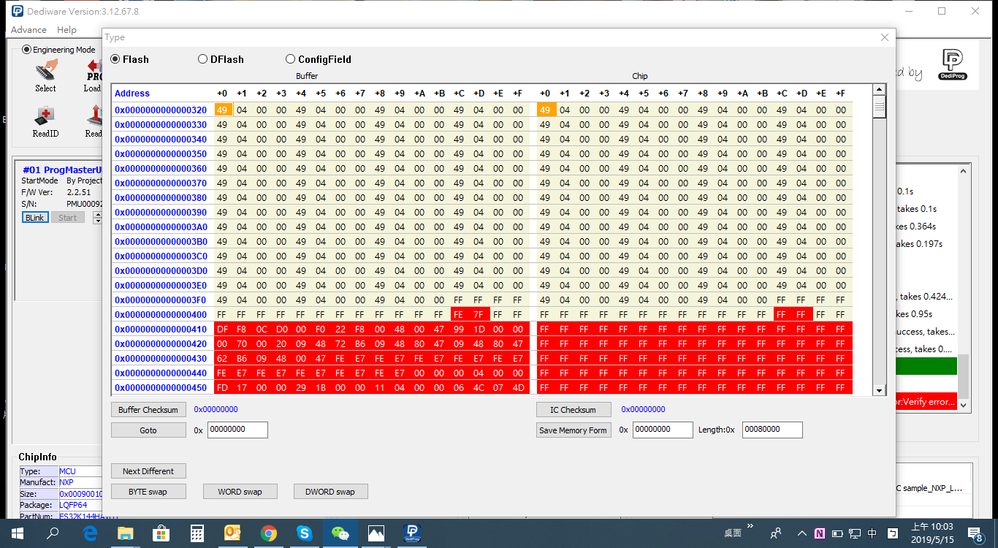

We face a issue that the content 0x7F is written at address 0x40D, and then programmer read the contents are blank(0xFF) at address 0x400 to 0x7FFFF after power cycle. if we change the content from 0x7F to 0xFF, and the content are correct at whole flash after power cycle. i think whether we have to set up the register in the initialize process and avoid the issue is happened.
Left side is content in software buffer ; Right side is content of chip.

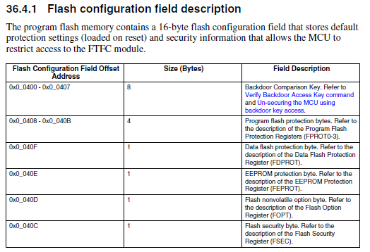

As you can see in AN12130, Section 3.2 Erasing flash, during the Mass Erase operations, the flash configuration field is programmed to 0xFE (unsecure). Then, you cannot write the same phrase again without erasing it first.

   In Step 3, we execute SWD mass erase. When the operation is done 0x40F is 0xFE, others register is 0xFF.
   Guess this is the reason why 0x408 - 0x40F can't be programmed.

if programmer write the 0x7F/0x7D at address 0x40D (flash), the programmer reads the all 0xFF at address 0x400 ~ flash end address after power cycle. if programmer write the 0xFF at address 0x40D (flash), the programmer can read correct content from whole flash.

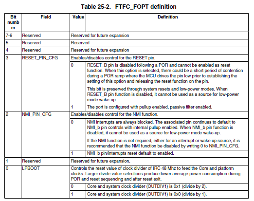

Why do you program the 0x40D byte to 0x7F?
This is the FOPT byte that is loaded to the Flash Option Register (FOPT) register at reset and the 4-7 bits are reserved.

You wrote: "... and then programmer reads the contents are blank(0xFF) at address 0x400 to 0x7FFFF after power cycle". If the 0x40C address was 0xFF, the MCU would end up secured and the access to the flash would not be possible without another mass-ease operation. Please see the description of FSEC  (36.4.4.1.4 Flash Security Register (FSEC), in the RM. rev10).
