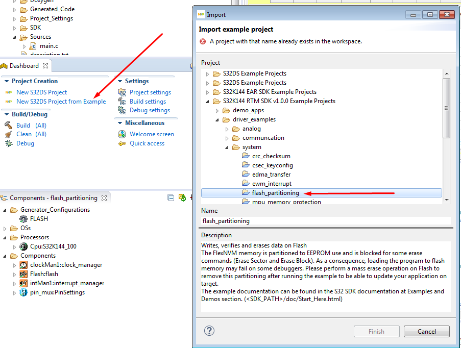

The FlexNVM partition example code is already part of SDK.
I hope it helps you.
