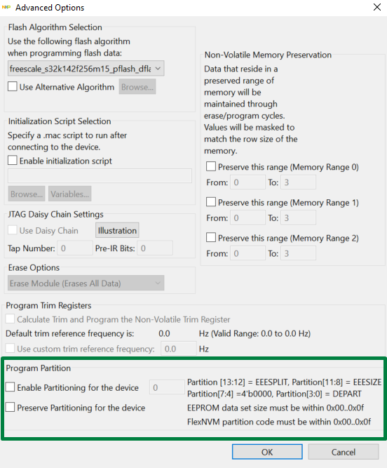

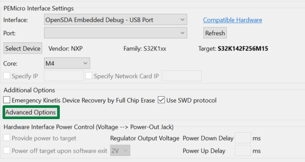

Hi All.
I already asked this question in a previous post but I would like to put it in a dedicated tiket (See Lock up event on Flash partitioning ).
Is the "Program Partition command" a procedure which has to be execute through executable code located in RAM?
Shall I have to perform an overlay?
I'm asking so because in the device's RM (Rev. 6, 12/2017) I noticed this recommendation in § "35.5.11.14 Program Partition command" which states :
Program Partition command must not be launched from flash memory, since flash memory resources are not accessible during Program Partition command execution.
2,222 Views
danielmartynek
Hi Andrea,
You can find the statement in the latest RM rev.11 as well.
It can be launch either internally from RAM or by a programmer.
