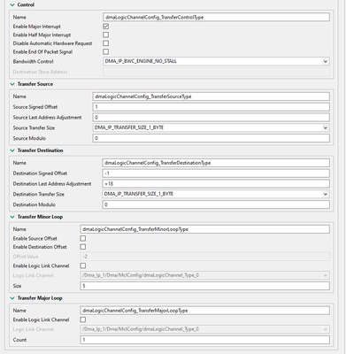

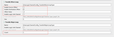

Using DMA SPI in S32K3, how can I operate the target address offset after the Major Loop completes a count? Now  i have achieved the Minor Loop target address offset, how can i configure the Major Loop target address offset.
I want to achieve a Minor Loop target address offset of - 1byte and a Major Loop target address offset of 8Byte. How do I configure DMA?

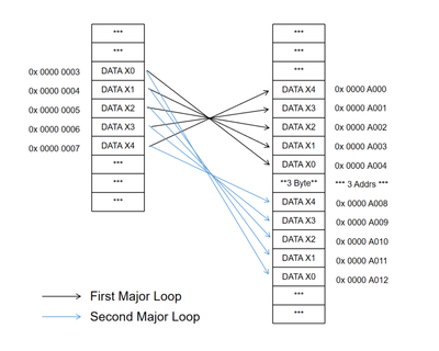

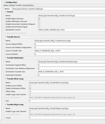

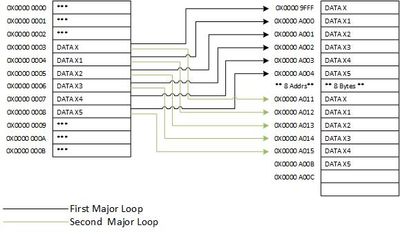

Sure,
I edited the dma_ip example to create the desired behavior on the channel 0. The only difference is that I set a space of 8 addresses in the destination buffer.
2,713件の閲覧回数
JRoberto
Could you confirm this is the desired behavior please?

FOR_EACH
That's what I want.

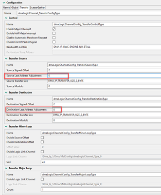

JRoberto
Hello @FOR_EACH
You can use this parameters to set the offset after every minor or major loop
Best Regards!

Hello @JRoberto
Can you give an example of how to configure? Because I've configured it like this, but it doesn't achieve the effect I want.
