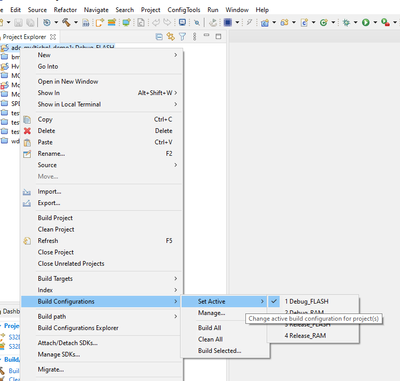

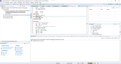

I am using the micro S32K344 and I have a big problem when I debug my projects. When I debug the projects, the program starts in the memory sram and I want to start in the memory flash. I suppose that is the problem but I don´t know. I want that when I debug the project, it starts in the main. In the next picture you can see the problem. I need the solution as soon as possible please.
Simply set the target to FLASH.
https://community.nxp.com/t5/S32-Design-Studio-Knowledge-Base/HOWTO-Build-a-Project-and-Setup-a-Debu...
Well, every program starts with boot and startup procedure. Starting directly in main with not initialized micro would simply not work.
