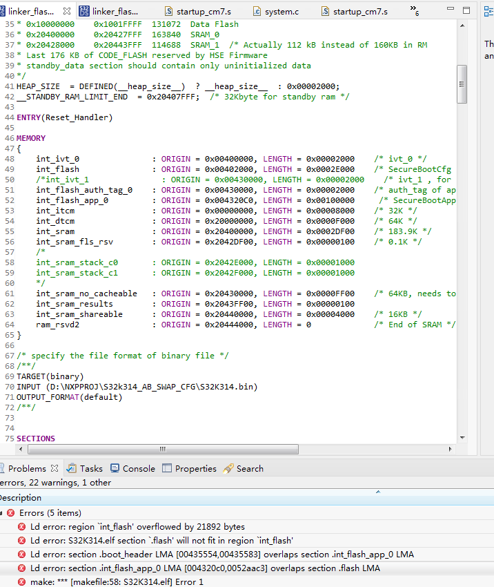

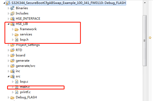

I downloaded the following program from the official website and after configuration, it was compiled successfully and can run on the 344 template. However, at that time, RTD1.0 was used for compilation. I started thinking of porting the entire set to RTD3.0 and found many errors. So, I only ported the HSE-LIB and main. c sections in the src. During the compilation process, there were some problems, and some libraries could not be matched. Therefore, I changed the library corresponding to 344 to 314, Then some functions in the main are masked, such as the BackupOnPassivesection function. As of now, I have only modified the memory section in the LD file to ensure matching, but the subsequent section still reports errors. Although it appears to be one or two errors, once I modify one, other errors will continue to be reported, At present, I hope to modify an advanced secure boot (based on RSA) program that can run normally on the current 314 sample, which will facilitate my future development. Thank you!

unfortunately we do not have such sample code written directly for S32K344.
The errors show a problem in the linker file. Why did you updated the linker file in this way? S32K344 and S32K314 have the same memory layout, so you can use the same definition of MEMORY as in original example for S32K344.
For example, configuring of int_ivt_1 to 0x00430000 does not make sense because this is not valid IVT location.
I would start with the same linker file.
Lukas

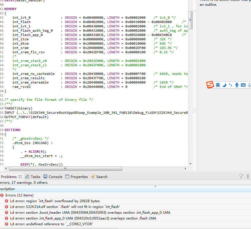

Because currently some routines S32K344_SecureBootCfgAB-SWAP can be run on the 344 template, but we want to port it to 314. Due to the large difference in linkfiles and the lack of specific documentation on how to modify them, I can only copy them from the routine to the 314 project for modification and adaptation. For the address 0x00430000, I have already blocked it in 314, but there are still many other errors, as shown in the following figure, If there are documents and tools for quickly configuring linkfiles, that would be the most convenient,4.png4.png

Well, it's standard GNU linker file, so you can find documentation in the build tools folder:
c:\NXP\S32DS.3.5\S32DS\build_tools\gcc_v10.2\gcc-10.2-arm32-eabi\arm-none-eabi\share\docs\pdf\ld.pdf
And there are many tutorials on the web. We do not have other documentation for this.
