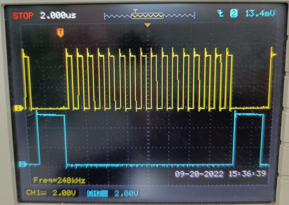

Hello NXP,
I am working on SPI
PFA of my waveform that i got for chip select
blue one is clock and the yellow one is the chip select
i am not getting the correct waveform I am using the below code please check once and reply soon

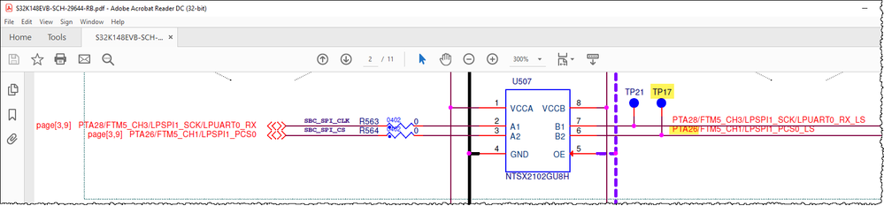

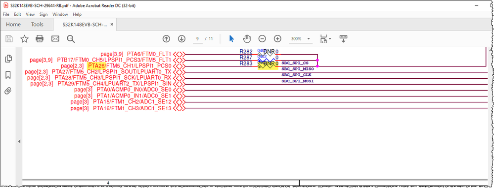

Hi RishikeshB,
Where did you measure the LPSPI1_PCS0 signal? The R283 on S32K148EVB is DNP, so you may need to measure the signal at TP17.
PTA26 LPSPI1_PCS0 S32K148EVB.pngPTA26 LPSPI1_PCS0 S32K148EVB.pngPTA26 LPSPI1_PCS0 TP17 S32K148EVB.pngPTA26 LPSPI1_PCS0 TP17 S32K148EVB.png
Seems that you are test the S32K148_Project_LPSPI bare metal example. Did you consider to test LPSPI SDK examples?

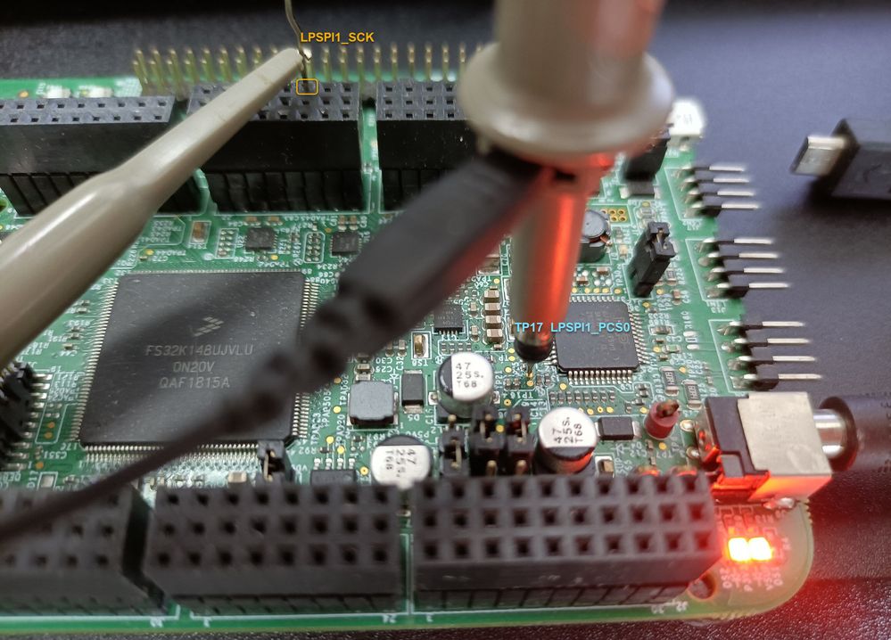

Robin_Shen
Below signals are measured on S32K148EVB-SCH-29644-RB. J8 1-2 (P5V0_V1SBC P5V0). J7 2-3 (VDD P5V0)
TP17 S32K148EVB.jpgTP17 S32K148EVB.jpgLPSPI1_SCK LPSPI1_PCS0.jpgLPSPI1_SCK LPSPI1_PCS0.jpg
