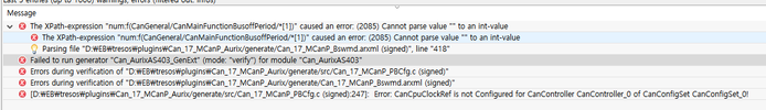

Hi, I was trying to generate the .cfg files for the Can plugin using Tresos.
I get the following error and could not understand the reason.
An error is thrown, but it is generate project
Thanks for your helps !
Best Regards.

Hi L_duncan,
Could you send me the configuration files (.xdm files) in your project?
Dan
5,130 Views
DanNguyenDuy
Hi L_duncan,
Have you ever filled the value for this node?
If you tried and the generation still fails, please send me your configuration files.
Dan
5,117 Views
minsiklee
Contributor V
Hi Dan,
Thanks for reply.
I filled that node, But the error occurred.
1) What does "signed" mean in error?
2) File uploads are limited, so I'm attaching configuration CAN.xdm as below text.
Duncan
