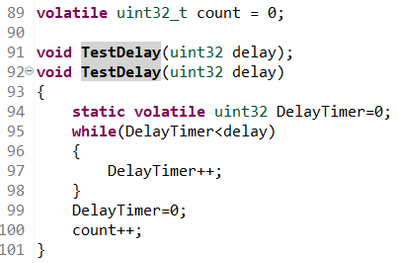

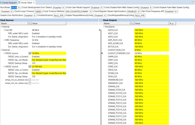

I am trying to implement a TestDelay but I don´t achieve nothing. I want a bucle that stay on it for 10 seconds. I have added diferent functions but I don´t achieve my target. I have also sent the configuration of the clocks. I want to enter to the bucle and if I push the button in this time, the variable "result" is True.
The problem is that the I don´t know the number I have to implement in "TestDelay()". Moreover, the function makes different stranges things because comes to "Boot_IsRequest" function. I need a reply as soon as possible as I have to send the project very soon.

Hi @JonAnder_Amante,
This SW delay will never be precise, it depends on many things.
ARM does not specify execution time of the instructions, there is the cache, etc.
The compiler can optimize it out.
Have you considered using a HW timer?
BR, Daniel
If you use RTD driver, you can use the system clock for it. The drivers use OSIF for timeouts. There are APIs like OsIf_GetCounter().
Or the RTC can be used.
It depends on what precision you need.
What is the delay in your project now? Can you use GPIOs to measure it?
