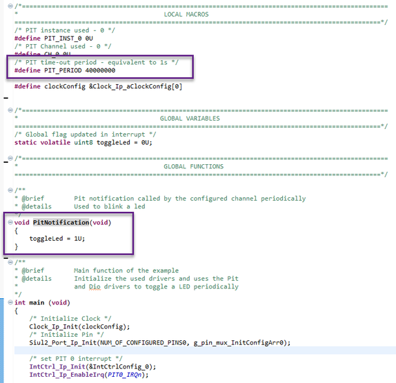

danielmartynek
Hi @JonAnder_Amante,
I don't see any interrupt configuration there.
You are using a SW delay, which will never be precise regardless of the clock configuration.
To get a precise delay, you need a HW timer to measure the 1s precisely.
2,720 Views
JonAnder_Amante
I only want to have a time that more or less It´s about 10 seconds.
Could you tell me the steps to do this option?
Could you tell me the steps to make a hardware interrupt each 1 second?
Thank you,
2,713 Views
danielmartynek
Refer to this RTD example: Pit_Gpt_Ip_Example_S32K344
It toggles an LED from PitNotification() every 1s.
