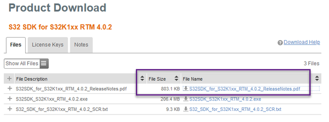

Have a look at the release notes of the SDK package.
The only supported S32DS IDE is version 3.4.
Please use the 3.4 version.
