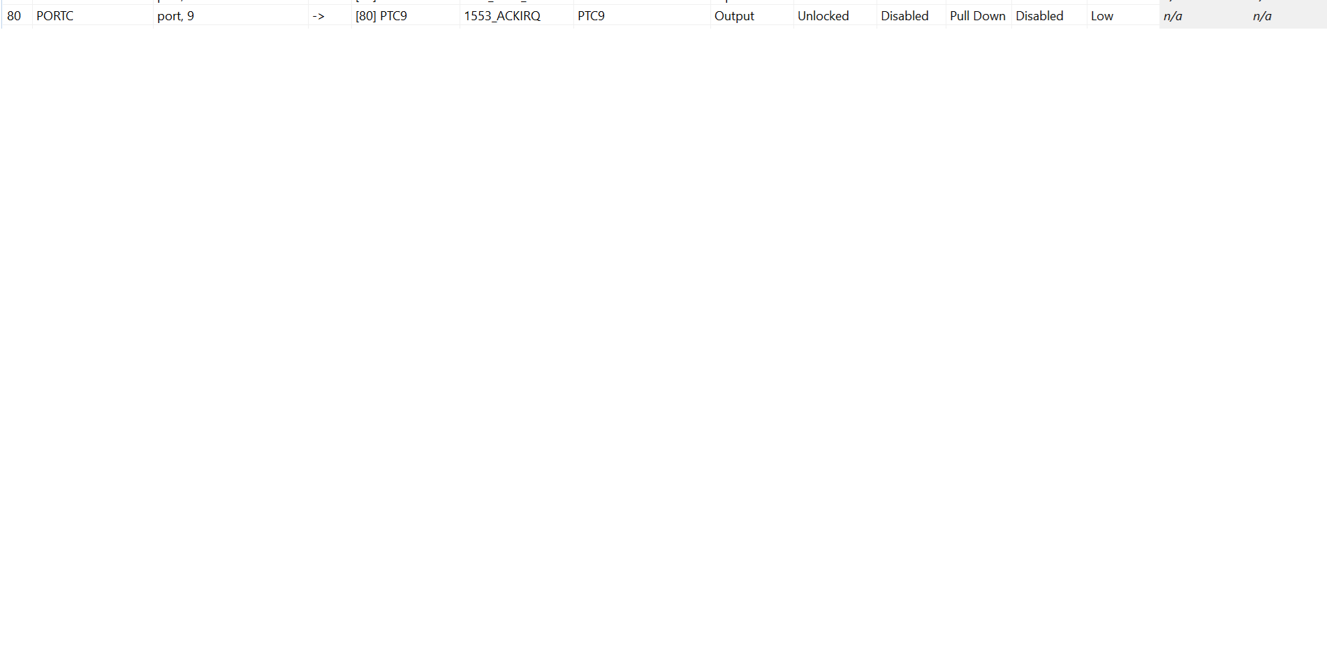

Thank you for your feedback. This does answer some of my questions. But the actual issue that I am struggling with (and one that is not happening with the example code) is that in my project running on a custom designed board, all the GPIO lines are marked as input in the generated code, even when they are configured as output in the PinTool.
Here is an example: as you can see, pin PTC9 is configured as Output in PinTool:
Update Code has been executed (the button is gray)
The generated code (board/Port_Ci_Port_Ip_Cfg.c) is this:

3,655件の閲覧回数
VaneB
Hi @durga_choudhury
I created a project from scratch using the exact same RTD version you mentioned, and on my side I am able to see the value correctly updating from input to output in the generated code when making changes in the Pins Tool.
Could you please share your .mex file so I can verify if something is missing in your configuration?
Any additional information you can provide would also be helpful.
