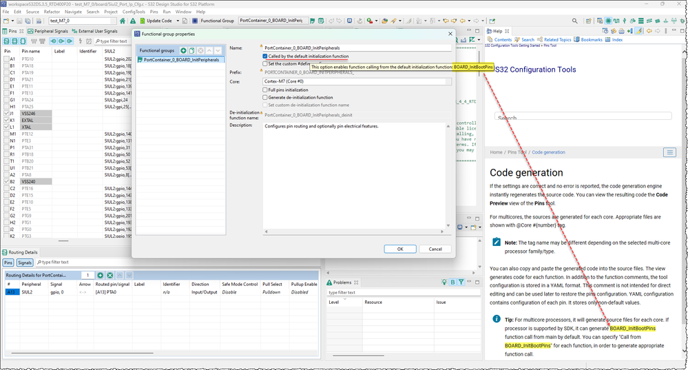

I have updated the S32DS to v3.5.13 and RTD version to 4.0.0 P24.
After the update the Port configuration has errors regarding the naming of the functional group in the Pins Tool.
The error says that I should rename the PortContainer name, the thing is I have multiple PortContainers, and that would mean I need to create a separate functional group for each. But only one functional group can be initialized by default.
How can I fix this issue while having one functional group in pins tool ?

I saw the prompt Called by the default initialization function, but I did not find where Board_InitBootPins was called.
The RTD example calls:
Siul2_Port_Ip_Init(NUM_OF_CONFIGURED_PINS_PortContainer_0_BOARD_InitPeripherals, g_pin_mux_InitConfigArr_PortContainer_0_BOARD_InitPeripherals);
Have you considered calling the remaining Function groups by their names?
    Siul2_Port_Ip_Init(NUM_OF_CONFIGURED_PINS_PortContainer_1_BOARD_InitPeripherals, g_pin_mux_InitConfigArr_PortContainer_1_BOARD_InitPeripherals);

Please change the Name in Pins Tool: for example PortContainer_0_BOARD_InitPeripherals
PortContainer_0 BOARD_InitPeripherals Peripheral Tool.pngPortContainer_0_BOARD_InitPeripherals Pins Tool.png

That works fine if you have only one port container, but I have multiple, and that won't work unless I create a functional group for each

Yes, it is an option to call all of the Functional Groups with Siul2_Port_Ip_Init, the only downside is that when you have a lot of Functional Groups you have to call the init function a lot of times. Thanks for the response.
