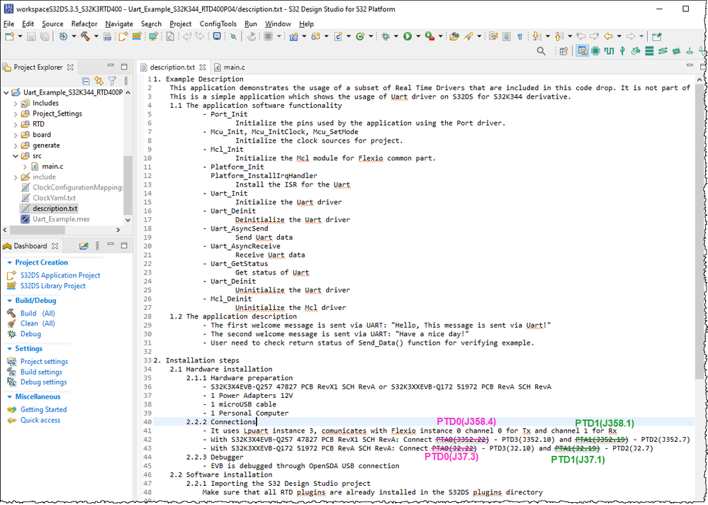

Hello, I'm using the S32K314 model and working on creating an app by incorporating the 'RTD 4.0.0' SDK. I want to utilize UART functionality using Mcal instead of Ip. Currently, I am referring to the Uart_Example_S32K344 sample code, but it seems like the configuration is not working well. If I'm only using UART, do I just need to add Mcal drivers such as Mcu, Platform, Port, and Uart? Also, in the example, I noticed the use of FlexIO. Are these pins physically connected?

The hardware connection mentioned in Uart_Example_S32K344_RTD400 description.txt is wrong. According to the configuration of Port component:
Flexio0_Tx PTD0 GPIO[96] should connect to Lpuart3_Rx PTD3 GPIO[99]
Flexio1_Rx PTD1 GPIO[97] should connect to Lpuart3_Tx PTD2 GPIO[98]
Uart_Example_S32K344_RTD400  description.pngUart_Example_S32K344_RTD400 description.pngUart_Example_S32K344_RTD400 PTD0 PTD1 PTD2 PTD3.pngUart_Example_S32K344_RTD400 PTD0 PTD1 PTD2 PTD3.png

chappie_o
Thank you for the kind explanation. However, could you please tell me why Flexio is used?

Robin_Shen
I think it's just to demonstrate FlexIO_UART and LPUART communication in a sample project. Please delete the FlexIO related parts if you don't need to use FlexIO to implement the UART function.
