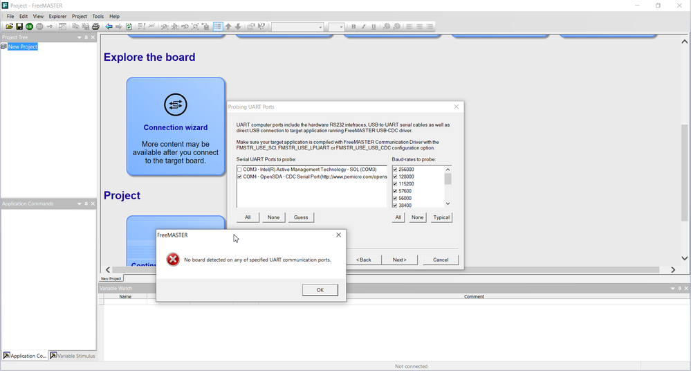

4. Installed freemaster and tried to connect to the eval kit and got below error.
Please let me know why am i facing this issue and how to resolve this asap.

4,788 次查看
AdityaB
Dear @Robin_Shen ,
Please comment on Points 3 and 4 as to why either S32Ds or FreeMaster is not able to Connect to the eval kit.

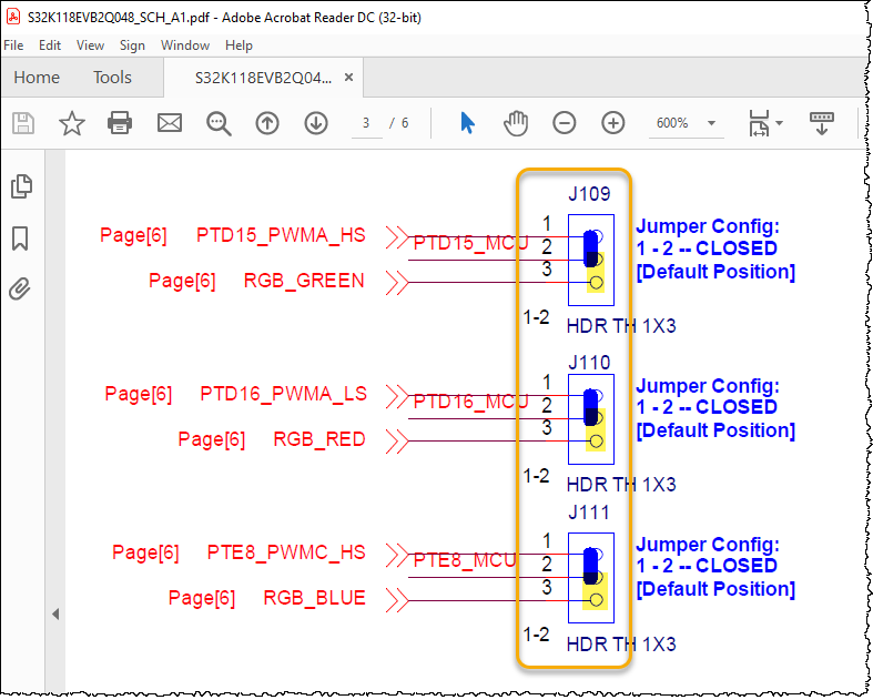

The default setting of J109\J110\J111 connect 1-2, but should be 2-3 in order connect the signals to GRB LEDs.

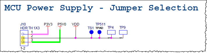

Try to connect 2-3 of J10, power the VDD of MCU by P5V0.

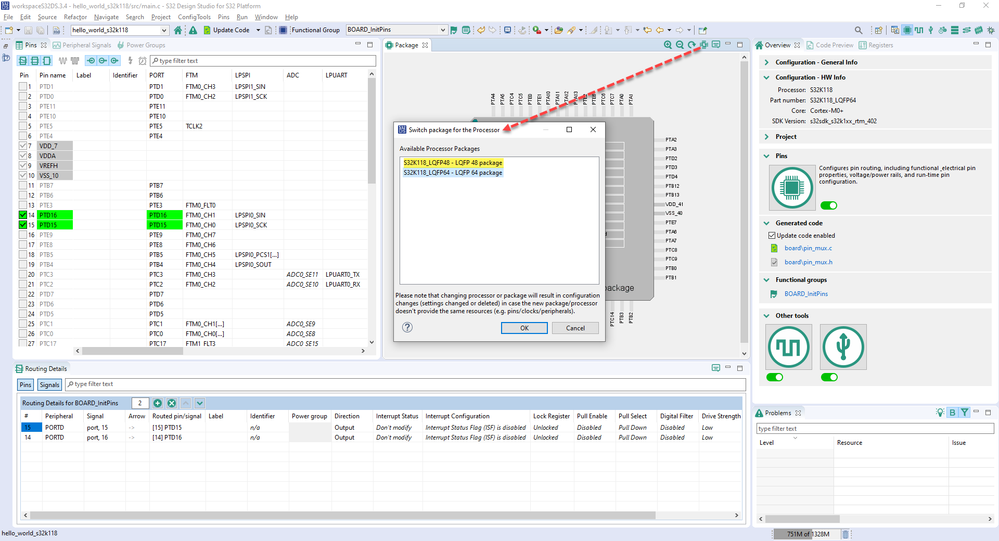

I didn't find other difference, so you can use:
S32 Design Studio for S32 Platform Version: 3.4
S32 Design Studio S32K1XX SDK RTM 4.0.2
Remember Switch package for the Processor and Update Codes.
