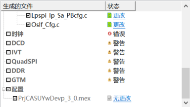

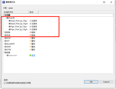

When I use S32DS for Platform 3.5 update (8) to configure a project for the S32K312 chip, after configuring peripherals and clicking to update the code, it shows errors with peripherals and clock. However, I'm using the default project, the clock hasn't been configured yet, and the peripherals are set to default values. The RTD version for S32K312 is 3.5.13.20240726.
1,869 Views
Robin_Shen
Even for newly created S32K312 project, there are default configurations in the Clocks Tool. Please enable code generation for Clocks.

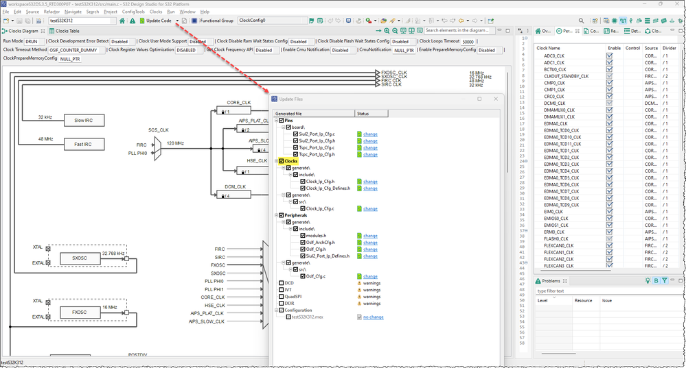

TWL
The following image shows my operation. When I created a new project, I opened all code generation tools, and when I clicked update code, the following error was displayed.

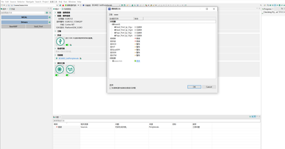

TWL
I followed the steps you provided, but I'm still encountering the issue mentioned above.
