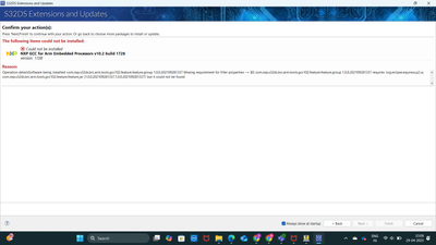

Hello all,
      I am working with the S32K148 Microcontroller. While I am installing the Packages in S32DS, I am unable to install those packages. I am getting the error as shown in the picture. Help me with this.

Are you installing S32K1 SDK or RTD?
Please refer to the third step of HOWTO: offline install S32K1 RTD 2.0.0 in S32DS v3.5
This includes NXP GCC for Arm Embedded Processors v10.2 build 1728

I have installed everything as mentioned in https://community.nxp.com/t5/S32-Design-Studio-Knowledge-Base/HOWTO-offline-install-S32K1-RTD-2-0-0-... . After Installing I tried to build example project and I got errors as Header Files Missing. It is happening with all example projects. Help me with this.

Please follow the description.txt of the project. Did you click on the "S32 Configuration Tool->Update Code" button?
3. Generating, building and running the example application
3.1 Generating the S32 configuration
Before running the example a configuration needs to be generated. First go to Project Explorer View in S32 DS and select the current project.
Select the "S32 Configuration Tool" menu then click on the desired configuration tool (Pins, Clocks, Peripherals etc...).
Clicking on any one of those will generate all the components.
Make the desired changes (if any) then click on the "S32 Configuration Tool->Update Code" button.
