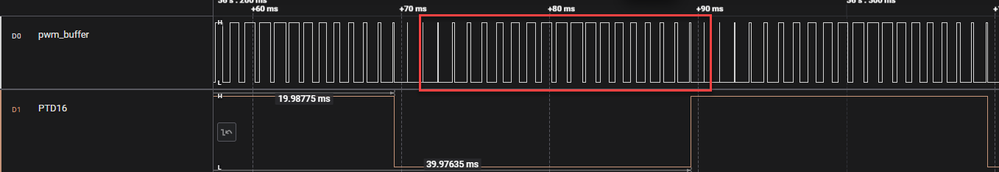

Hello NXP team,
i am using S32K144 MCU.
I want to use PWM with DMA, but I want to provide the values through an array. Where through a single function call, it takes these values and provides them as output.

Hi@adem_marangoz
Sorry for the long waiting.
The demo based on S32K144EVB, the SDK is RTM 4.0.03, IDE is S32 DS V3.4
Each time the trigger is triggered, the values ​​in the pwm_buffer array are sequentially
transferred to the Cnv of the FTM0-ch0 to change the output PWM.
