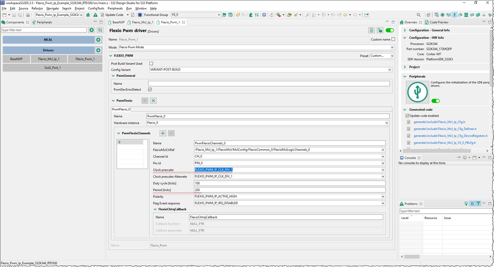

I am using S32K344 to generate PWM via eMIOS and flexio using OPWMB?
i have some dough regrade to the formular for calculating  the PWM frequency ?
PWM frequency = CORE_CLK / global prescaler / internal prescaler / (B1+1)
I am using this formular for Emios can i use it also for flexio?
7,844 Views
Robin_Shen
FlexIO PWM frequency = AIPS_PLAT_CLK/ Clock prescaler / Period[ticks]=48MHz/1/200=240 kHz

Robin_Shen
I don't think this formula for eMIOS can be used for Flexio_PWM. Have a look at Flexio_Pwm_Ip_Example_S32K344:
Flexio_Pwm_Ip_Example_S32K344_RTD300 FlexIO AIPS_PLAT_CLK.pngFlexio_Pwm_Ip_Example_S32K344_RTD300 FlexIO AIPS_PLAT_CLK.pngFlexio_Pwm_Ip_Example_S32K344_RTD300 Clock prescaler Period.pngFlexio_Pwm_Ip_Example_S32K344_RTD300 Clock prescaler Period.png

Ayaz
what is the formula for flexio_pwm ?
7,845 Views
Robin_Shen

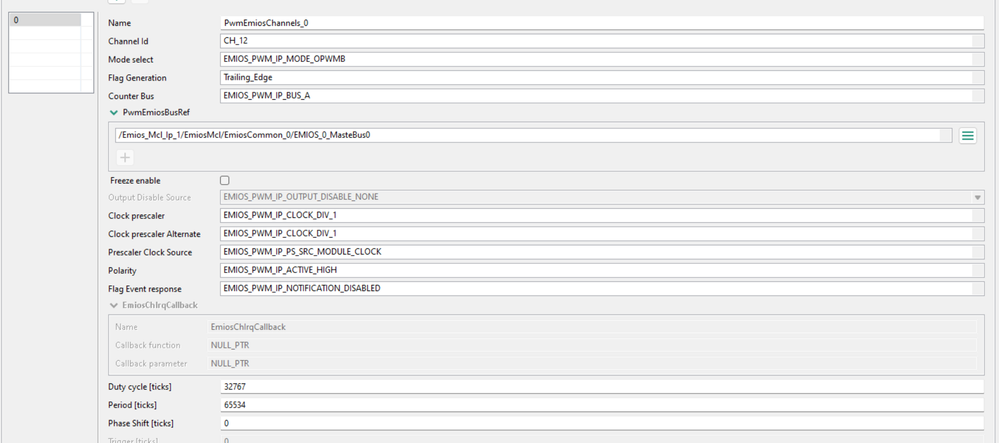

Ayaz
 first 1)
is the formular i am using for eMIOS correct ?
 PWM frequency = CORE_CLK / global prescaler / internal prescaler / (period ticks+1) or shoud it be
PWM frequency = CORE_CLK / global prescaler / internal prescaler / (period ticks).
second 2) when i have for example period for 2400 ticks and i set duty cycle into 2400,100% duty cycle is not giving any output,but if i decrease the duty cycle only be  one ticks then the period then it will gives an output of 98,7%.
my setup is
CORE_CLK=48MHz
global prescaler=1
internal prescaler=1

Robin_Shen
eMIOS PWM frequency has been discussed in S32K344 hardware PWM frequency, which is:

Ayaz
under the example you send me this formular is for OPWFMB mode
does this formular applies on OPWMB mode also?
7,722 Views
Robin_Shen
Note Clock prescaler(Internal Prescaler) Will only have an effect in OPWFMB and OPMCB modes.(Shown in S32 Configuration Tool). If OPWMB mode is selected, only global prescaler(Master Bus Prescaler) is active by using S32CT.

Robin_Shen
Yes, I think it's the same.

Ayaz
is it normal that if i apply 2399 ticks for period and i set the duty cycle 2399 to get 100% duty cycle ,is not giving my any output ,from the test i did ,the duty cycle most always be one ticks less the period to get 100% duty cycle ,it is for emios
