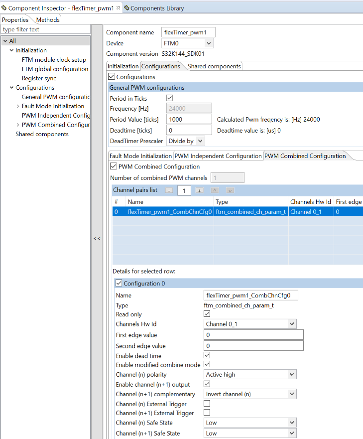

        I want to get 4-channel PWM signals which have the same frequency and complement  each other when I use S32K144, can I get example code ? Thanks!
1 返信
2,525件の閲覧回数
danielmartynek
You can refer to the ftm_combined_pwm_s32k144 SDK example in the S32 Design Studio.
It utilizes 2 PWM channels in combined complementary mode.
You can add another pair of channels.
One FTM instance has only one counter so all the PWMs will have the same frequency.
