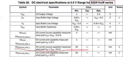

The S32K1xx Data Sheet (Rev. 14) defines VOH and VOL at specific current levels. If your circuit draws more current than allowed, the output voltage may not reach the expected high or low levels.
Also, not all pins have the same drive strength. Some are designed to handle more current. You should check the I/O characteristics section in the datasheet for details.

My application is to configure PTC2 as FTM0_CH2 channel. Currently, this PTC2 pin is only connected to the oscilloscope probe and not to any other load, so there is no problem of output current exceeding the standard.
And it was me who configured the six channels of FTM0, only this FTM0_CH2 has a problem, while the other channels are normal.
I tried to increase the driving capability of PTC2 to a level of 20mA (as shown in the figure below), but the problem still persists.
