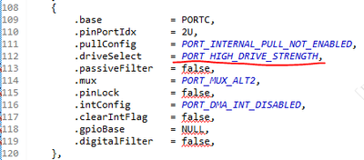

I had PTC2 (yellow waveform) and PTE7 (blue waveform) ports periodically reverse, and found that PTC2 (yellow waveform) could not drop to 0V, as shown in the following figure.
The configuration parameters of PTC2 and PTE7 ports are as follows:
I look forward to your reply.

Based on your suggestion, I have consulted relevant technical materials and conducted relevant tests, but the problem has not been resolved.
yellow waveform :PTC2;
blue waveform    : PTC3;
Let me add the background of my port usage:
My application is to configure PTC2 as FTM0_CH2 channel. Currently, this PTC2 pin is only connected to the oscilloscope probe and not to any other load, so there is no problem of output current exceeding the standard.
And it was me who configured the six channels of FTM0, only this FTM0_CH2 has a problem, while the other channels are normal.
I tried to increase the driving capability of PTC2 to a level of 20mA (as shown in the figure below), but the problem still persists.
