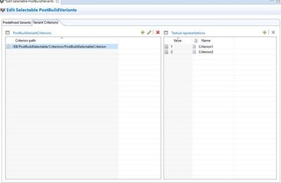

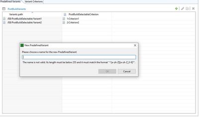

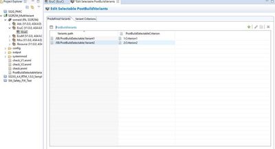

1. In Sidebar tab, choose Edit Selectable PostbuildVariants
2. Add a new PredefinedVariant
3. In Variant Criterion, add criterion and value representation

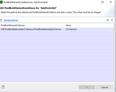

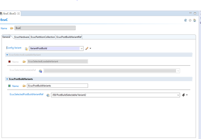

4. Close the Edit Selectable PostbuildVariants. In Ecuc, enable the EcucPostBuildVariant, then choose the reference variant selected

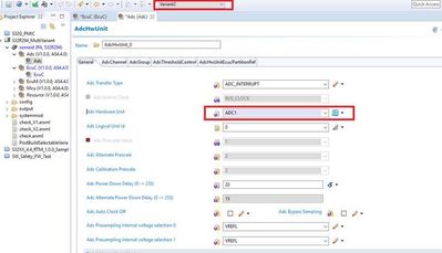

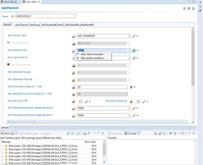

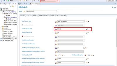

5. In Adc -> AdcHwUnit, add a new HwUnit, then edit the Variant condition in Adc Hardware Unit
6. For each variant, choose the corresponding Value:
7. After that, for each variant, different Adc Hardware Unit value can be chosen.

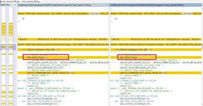

Code generated are different between each files:
