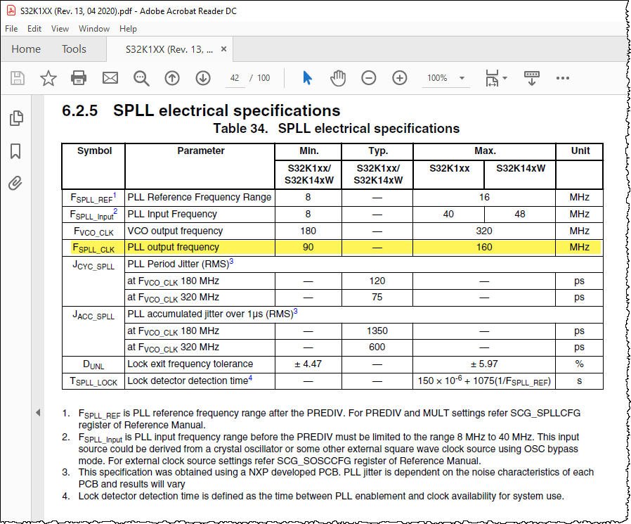

chinmayt1
I am using S32K118 and using processor export to generate driver code.
How can I boost the SOSC clock frequency? we are using 8MHz crystal and we want maximum 48Mhz SOSC clock frequency.
1,927 Views
chinmayt1
i want core clock to be 48MHz using external oscillator.
I am using S32 Design Studio and S32K118_SDK version 3.0.0. As answered in community question "SPLL_CLK can not slected as SCS_CLK'
PLL is not available for S32k11x product.
So how I can configure clock to multiply 8Mhz crystal clock to get 48 MHz using S32_SDK_S32K component?

Robin_Shen
Oh Sorry for my wrong reply!
SPLL mode is not available in S32K11x series of devices. So there is no way to multiply 8Mhz crystal clock to get 48 MHz.
Are you considering using 48MHz FIRC?  Or use an external higher frequency crystal?

Robin_Shen
Hi chinmayt1,
Do you want the SPLL_CLK to be 48MHz?
Or just need the Core clock to be 48MHz?
If you check the "6.2.5 SPLL electrical specifications" of S32K1xx MCU Family - Data Sheet (REV 13), you will find the minimum frequency of SPLL_CLK is 90MHz.
