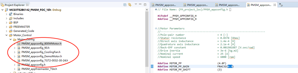

Single chip microcomputer model        FS32K142HAT0MLFT
demo                                                    MCSXTE2BK142_PMSM_FOC_1Sh
I want to know how to set motor starting parameters, such as motor resistance, motor inductance, motor pole pairs, starting current.
I found that there are multiple files for setting motor parameters, but I don't know whether it is called or how to call it.
I look forward to your reply and thank you very much.

it should be described in chapter 6 of the demo SW user guide; https://www.nxp.com/docs/en/user-guide/MCSXTE2BK142_SW-UG.pdf
BR, Petr
