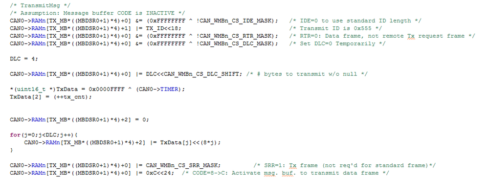

I'm working with S32K144 CAN Module for my TPMS Project.
I have faced some problems with FlexCAN communication, I'm taken the Sample example of non-SDK FlexCAN for my project during my testing I couldn't see any CAN Data Signal in MCU CAN_TX pin.

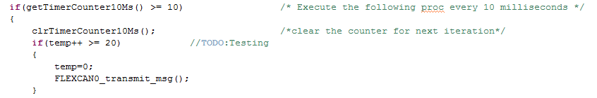

Call every 200Ms interval for the Testing purpose.

with scope, I have tapped CAN_tx Line but no Frame format Signal. This Pins state just High.
Please, what could be the Problems with my source.
