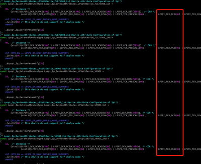

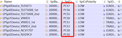

Hi NXP exports,
The PCS value can't be generated by EB, and I have double checked SPi configuration is right.
but actual code ,the PCS is always 0.

zp001
Hello Nam,
SPI configuration files have been uploaded, please help us check!
Thanks a lot!

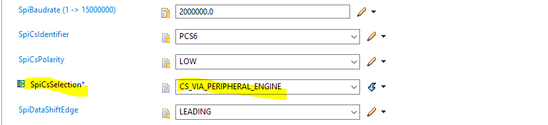

namnguyenviet
Hello @zp001,
Please enable the SpiCsSelection, and then select CS_VIA_PERIPHERAL_ENGINE:
After that, I can see PCS had value:
Nam
