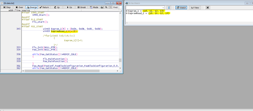

Hello @tianxing,
I have tried your project, unfortunately I wasn't able to reproduce your issue: I modified the EepromRead_1[] to have only 4 bytes, still I could see the read data was correct (I also tried with other programmed data). See below snapshot:
Except the modification of the store buffer and the comment out of FlexCAN (I didn't configure FlexCAN receiver node), I didn't change anything and just re-compile the project. I have attached the project after modified.
Nam

tianxing
Thank you Nam
May be it is the JLink problem,I used the V9 JLink cannot work well with S32K344
And we bought V11 to solve this problem.

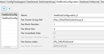

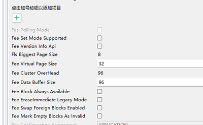

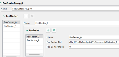

tianxing
Hi,please refer to  below picture and I share the source code in the attach file.
Thank you Nam.
