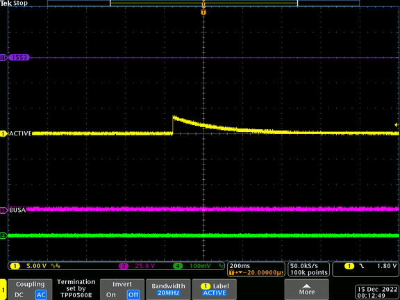

I have a GPIO pin that I wish to drive high.
The pin is connected with a 3.3k resistor to ground.
I expect the push-pull output to be able to drive this pin high, however it seems the 3.3k is pulling the line to ground.  The line goes up but immediately decays back to low.

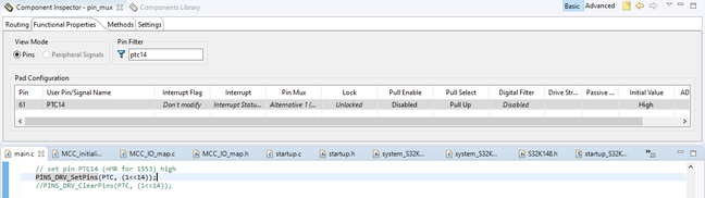

In the PEX config, the pin is clearly set to have pull-up/pull-down disabled.  Init value is high, but I also force high in the main function.

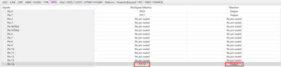

Yes, PTC14 is set to output in Routing tab, and Pull Enable is disabled in Functional Properties tab.  PEX is regenerated and program is rebuilt and programmed.  Finally, pull-down measures 3.3k.

Hi@m_mishrikey
please confirm again:
1.you already set the ptc14 like this,
2.measure whether the resistance value of the pull-down resistor is 3.3K
If there is nothing wrong with the above, I will test it  on myside.

I don't follow.  The spec says for a 3.3V rail, the outputs can source up to 3.5mA.  For a 3.3k external pull-down, that is only 1mA.  I would expect the output can recover even if the output capacitance is not sufficient.
I'm not loading the other outputs down heavily either, in case there was a question about total output over all ports.

Case of "toothache that went away".  I remeasured today and the pin is driving fine.  I can't explain it.
Sorry for the trouble, and thank you for checking.
