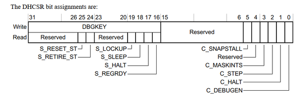

Op Bit(Operation bit) is required to avoid the Functional resets , while doing debug. as per my project requirement developed SWT and ExtWDG . but i cant do debug because once create any breakpoint , timer overflow shall be happen and system is going to reset. to avoid this condition in debug mode i need to check the Op Bit based on this i can decide is it debug or release .
3,538 Views
davidtosenovjan
So you want to detect in your code, whether MCU is in debug mode or not.
I have found some solution here:
https://stackoverflow.com/questions/59765691/arm-cortex-m-detect-if-debugger-is-in-run-or-debug-mode
DHCSR register contains status fields, containing information about debug state.

davidtosenovjan
DHCSR register is described in ARM documentation, specifically in the document
DDI0403E_e_armv7m_arm.pdf
as it is pointed by
DDI0489F_cortex_m7_trm.pdf
https://developer.arm.com/documentation/ddi0489/f/?lang=en
https://developer.arm.com/documentation/ddi0403/ee/?lang=en
