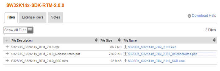

Dileep1441
Hi @danielmartynek,
I didn't installed SDK RTM 2.0.0, could you please share the required all software and packages links,
My requirement is to run the UDS in S32K144EVB.
I have the below software and hardware
Device: S32K144EVB evaluation board.
S32DS: S32 Design Studio for ARM--Version: 2018.R1
3,919件の閲覧回数

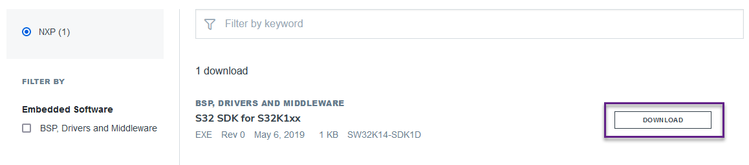

danielmartynek
Hi @Dileep1441,
The SDK package can be downloaded here:
https://www.nxp.com/design/software/development-software/s32-sdk/s32-software-development-kit-for-s3...
I believe this is all that is needed,
BR, Daniel
