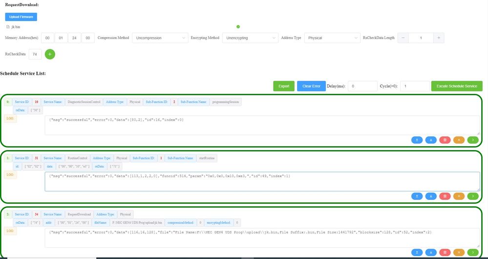

I have implemented the Unified Bootloader and am using the NXP open bus application, but when I try to update the firmware using the RequestedDownload the response is successful but the nxpopenbus software has not sent the data to the bootloader?
I have uploaded the CAN trace image showing the command response flow and a screen shot of the nxpopenbus software.

    Can you answer questions as below:
1. Which platform?
2. Do you modify the link file including bootloader and APP?
If you test over demo, Can you check your json file including flash driver and app path. The information including by 0x34 service. The service also include storage address. If needed, you can upload the json. I will check the file.

We are using the S32k148 processor and have modified the json file as per the instructions. I have uploaded one of the json files we created.
The message flow seems good up until the point where the nxpopenbus app needs to start sedning the data then it stops
Thanks for your support

      Check the JSON maybe have some problems as below:
1. The json have not include the access authority(0x27) check. Is modify the bootloader uds_app_cfg.c?
2. The json file have not include download flash driver. Is flash driver integrated in bootloader project?
3. The uds service 0x31 01 02 02 is check binary validty. Default is check flash driver and APP' binary over CRC.
4. The json file have not include UDS services 0x36(transfer data), 0x37(exit transfer data). Default process is 0x34(request transfer data), 0x36(transfer data), 0x37(exti transfer data), 0x31 01 02 02 xx (checksum check). The process pls reference HIS and UDS spec.
Suggestion you reference the default process provided by NXP. The detail UDS service or process pls reference HIS and UDS(ISO14229) spec.

Sorry - totally miss understood the process flow, I amended the json and it all works as described.
