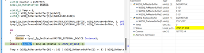

Here i ma trying to read JEDEC ID of external flash in half duplex mode bit always getting 0.
Can you please check why , even i have checked with altered the API being called in image for TransfersSync (Tx first, Rx second).

Sorry for the late reply, and the blurry image, I've replaced it.
How are you sending the commands to the W25 memory? I think the easiest way to debug this, is to read the Arduino's output, and compare it with the S32K312's output through a logic analyzer, or oscilloscope.
I can see from the git repository I've previously shared, all of the command definition is written in the w25qxx.c file. In this case, since this is a third-party device, you will need to implement these commands through the SPI functions.
Please share your project configuration, so I can test the SPI communication. Just keep in mind that I am not able to test the memory's init and read/write commands; I will simply analyze the SPI's frame through a logic analyzer.
