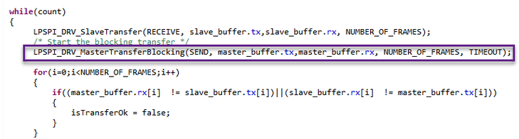

danielmartynek
Hi @YF_LYW,
If you don't need the periodic LPIT trigger for the DMA, you can refer to the lpspi_dma_s32k144 SDK example.
The transfer is triggered by this function:
3,843件の閲覧回数
YF_LYW
Hi @danielmartynek
Thanks for your quick reply. I study the example which you refer. And I find there are will be some data skipped in SPI-DMA. And I slow down the transmit speed as 1Mhz, almost half receive data is lost.
Could you give me some hints for this problem?
