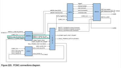

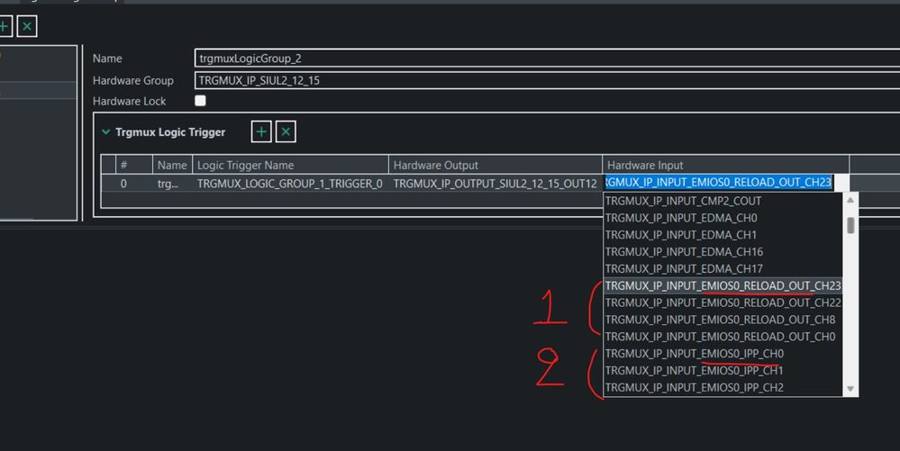

Can you please someone explain to me what exactly items noted in the image bellow (1, 2) represent ?
I've opened MCL driver manual but still, I could not understand which signals are the ones in the image.
1. What is "RELOAD_OUT" ?
2. What is "IPP" ?
3. Where are the two options described in the documentation ?

eMIOS_n_ipp_ind_emios_ch[ ] is the input to the eMIOS from the TRGMUX and eMIOS_n_ipp_do_emios_ch[ ] is the output of the eMIOS to the TRGMUX. For eMIOS_n_reload_out_ch[ ], eMIOS provides reload outputs,
To summarize they are simply input/output of eMIOS.
Regarding the image you post, these definitions are the value for the trigger selection logic of the TRGMUX module.
