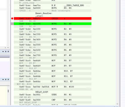

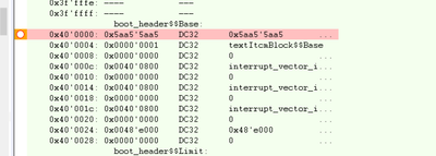

MCU Chip:NXP S32K312
To:
when i want to restrict the debug without HSE, i found LC can not be advanced。Can anyone give me some advice to fix that.
Below is the some information i have tried,
the zip includes the .s  and icf file。
qimaomarvin_2-1757301750415.pngqimaomarvin_2-1757301750415.pngqimaomarvin_3-1757301763583.pngqimaomarvin_3-1757301763583.png

Hi @qimao-marvin
The password and LC config word seems to be correct, I can see no problem here.
Isn't HSE firmware installed on this device? Could you check HSE GPR register at 0x4039_C028? If HSE firmware is installed, the LC config word is ignored and the life cycle needs to be advanced via HSE service.
Lukas
