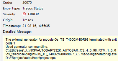

        I configure an OS project with EB tresos for NXP S32K146 platform.
        I have install eb tresos “setup.exe”、“S32K_AUTOSAR_OS_4_0_98_RTM_1_0_0.exe”、“JRE
6.0”, two errors will appear when verifying the project now,as below

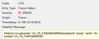

1).The external generator for module Os_TS_T40D2M4I0R98 terminated with exit code 1:
2).Failed to run generator "Os_TS_T40D2M4I0R98GeneratorId" (mode: "verify") for module "Os_TS_T40D2M4I0R98":
        Pls provide help to solve these two errors,thanks very much for your kind support!

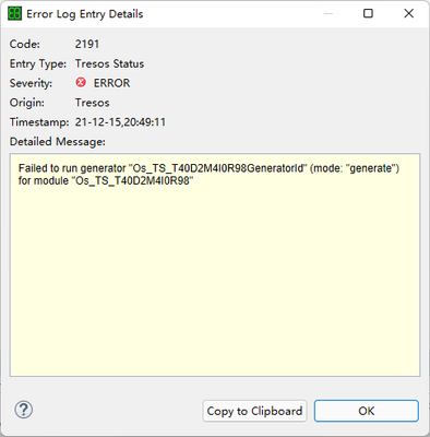

hello,have you solved it and could you share me the method? i met the same problem. the java environment is ok

hello,
You  should install  a 64-bit version of JRE. You can refer to this link: https://www.quora.com/How-do-you-know-if-youre-running-Java-in-32-bits-or-64-bits to know how to identify the JRE version.

hello, thx for your relay, I changed the JRE into 64-bit but the problem not solved

Then I'm not sure what could be the issue. Please try to install the SW in a new PC and see whether the issue persist.

You can refer to this thread: https://community.nxp.com/t5/MPC5xxx/How-to-run-MPC574xG-AUTOSAR-OS-with-EB-software/m-p/1210219#M17...
https://community.nxp.com/t5/S32K/AUTOSAR-OS-S32K1/m-p/1155195
Check whether the java has been installed in system environment path, and try with command line.
