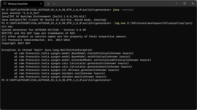

hello,have you solved it and could you share me the method? i met the same problem. the java environment is ok

namnguyenviet
hello,
You  should install  a 64-bit version of JRE. You can refer to this link: https://www.quora.com/How-do-you-know-if-youre-running-Java-in-32-bits-or-64-bits to know how to identify the JRE version.

JustVb
hello, thx for your relay, I changed the JRE into 64-bit but the problem not solved

namnguyenviet
Then I'm not sure what could be the issue. Please try to install the SW in a new PC and see whether the issue persist.

namnguyenviet
You can refer to this thread: https://community.nxp.com/t5/MPC5xxx/How-to-run-MPC574xG-AUTOSAR-OS-with-EB-software/m-p/1210219#M17...
https://community.nxp.com/t5/S32K/AUTOSAR-OS-S32K1/m-p/1155195
Check whether the java has been installed in system environment path, and try with command line.
