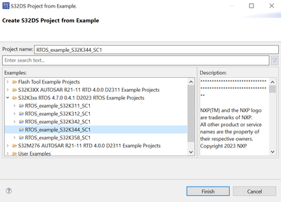

Hello all,
I would like to understand why the example "RTOS_example_S32K344_SC1" is not possible to build using Debug_Flash. Does anyone know it?
Is it possible to build with Debug_Flash? If yes, how?
I'm using RTD 4.0.0 and S32DS 3.5 versions.
I added new features on the example and I'm facing this error:

Hi @MVR
Sorry for the late response, due to workload my response was delayed.
Firstly, I must clarify that the software has code drop quality, its functionality is not completely tested, so it is not recommended for production.
The examples of this software are delivered only with RAM Linker File, so when you want to load it to Flash it will not be possible because the file required for this is not tested.
I apologize for the inconvenience.

Forget the error that I sent, I wanted to show the error only because I would like to use Debug_FLASH in the build configuration. So the main issue is: I would like to compile the NXP RTOS example code in Debug_FLASH mode and not Debug_RAM, can you provide the example compiling with Debug_FLASH, please?
I'm using this RTD:
S32K3x_NXP_RTOS_4_7_152_CODEDROP_0_4_1_DS_updatesite_D2312
and
S32K3_S32M27x Real-Time Drivers AUTOSAR R21-11 Version 4.0.0
This is the example that I would like to compile using Debug_FLASH:
