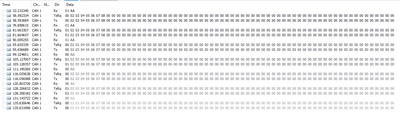

I am trying to CAN PAL sample code with CAN FD, but while getting TX message getting two Tx message(Tx and TxRq) at different time. Could you please let me know why we are getting two message and what is the meaning of TXRq? Adding below SS for reference.

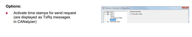

I found some descriptions about TxRq(those information comes from vector:CANalyzer_QuickStart)
