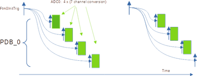

I want to generate multiple triggers for the ADC.
The PDB's input trigger originates from PWM:
Ftm0InitTrig -> Pdb0TrgIn. Relative to this, I want to generate ADC conversion on 600, 1300, 2000, and 2700 clock delays.
I can only make one trigger with (INST_PDB_0, 0, 0, delay) setup.
Did I misunderstand the PDB functions, or am I doing something wrong?

if the green box represents single ADC channel then you can achieve this by setting individual pretriggers delay. If it represents multiple channels then it can be done by using back-2-back mode, but just 2 multiple conversion can be initiated using both PDB channels.
BR, Petr

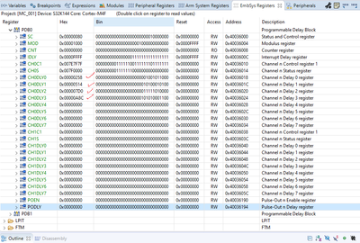

3,992 Views
Antal
Of these, only the first configuration is active with correct timing for any selected clock delay:
PDB_DRV_SetAdcPreTriggerDelayValue(INST_PDB_0, 0, 0, 600); // 640 -> 16us, OK
These are not triggering the ADC :
PDB_DRV_SetAdcPreTriggerDelayValue(INST_PDB_0, 0, 1, 1300); // 1300 -> 24us ?
PDB_DRV_SetAdcPreTriggerDelayValue(INST_PDB_0, 0, 2, 2000); // 2400 -> 33.6us ?
PDB_DRV_SetAdcPreTriggerDelayValue(INST_PDB_0, 0, 3, 2700); // 2700 -> 42.4us ?
I observed the ADC conversion in the ADC0_IRQHandler() using an output pin On/Off during the interrupt execution.

Antal
Hello Petr,
I don't understand your response.
Is the S32K144's PDB hardware support multiple delayed triggers, as the image depicts, or not?
If yes, and you know the solution can you share it with us?
Antal
3,942 Views
PetrS
BR, Petr
