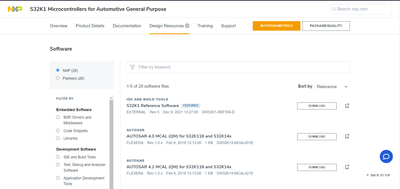

Hey All,
I recently bought the S32K116 Development Kit and wanted to get started using the code examples provided by the Motor Control Software. However, while setting everything up, I noticed the .elf file for the debugger was missing in my installation files.
My question would be, if there is a database where I can get the code examples from NXP directly. I tried reinstalling each software needed for the development board, but the files were still missing. There were no error messages during installation and I can open the software just fine. It's just missing the .elf file.
Help would be much appreciated
2,394 Views
yash_bhatnagar9
You can download the S32DS software from here "https://www.nxp.com/webapp/swlicensing/sso/downloadSoftware.sp?catid=SW32K1-REFSW-D"
After installing you can open the S32DS and install/update the extensions related to S32K1XX and the you can choose a example project by going to
You can also try to download the RTD for S32K1XX . It has example projects as well.
