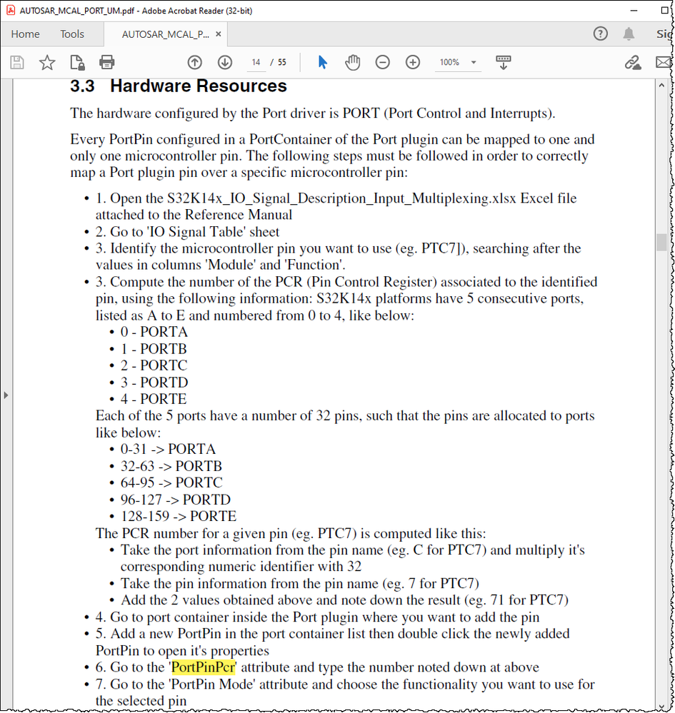

Could you please help me to figure out this issue:
When I am referring the excel file (S32K148_IO_Signal_Description) attached to the Reference Manual for Port Configuration of this particular parameter (PortPin Pcr ) in EB tresos tool. As per the IO signal Table sheet the pin we need to configure is Pin 15 for CAN Rx channel but in tresos if I configure the PortPin Pcr as 15 we are unable to select the PortPin Mode as CAN0_Rx and it is same for the CAN0_Tx Mode for Pin 14 in tresos.
Please find the attachments.
1 回复
930 次查看
Robin_Shen
Seems that you configure the wrong PortPin Pcr. Please read the AUTOSAR_MCAL_PORT_UM.pdf.
PORTE4 PortPin Pcr=128+4=132
PORTE5 PortPin Pcr=128+5=133
