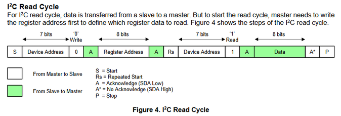

Eletronicc_23
Ok good, in this case to receive how will  be the example?, I understand if I send the register 0X00, it will send me back the state of the input to see how is the configuration of the Port depending the pin that I want to read. it is something like this:
#define RECEIVE_SIZE (2u)
uint8_t masterTxBuffer[TRANSFER_SIZE]={0x00};
uint8_t masterRxBuffer[TRANSFER_SIZE];
LPI2C_DRV_MasterSendDataBlocking(INST_LPI2C1, masterTxBuffer,RECEIVE_SIZE, true, OSIF_WAIT_FOREVER);
LPI2C_DRV_MasterReceiveDataBlocking(INST_LPI2C1, masterRxBuffer,RECEIVE_SIZE, true, OSIF_WAIT_FOREVER);

danielmartynek
The SendDataBlocking should not send the STOP condition in this case.
RECEIVE_SIZE should be 1 if you read just one register, but this depends on the Slave device, please refer to the datasheet of the device.

Eletronicc_23
ok in this case I want to read the input of PORT0 that is the register 0x00, so it will be like this my friend if I am not wrong:
#define RECEIVE_SIZE (1u)
uint8_t masterTxBuffer[ RECEIVE_SIZE]={0x00};
uint8_t masterRxBuffer[ RECEIVE_SIZE];
LPI2C_DRV_MasterSendDataBlocking(INST_LPI2C1, masterTxBuffer,RECEIVE_SIZE, false, OSIF_WAIT_FOREVER);

danielmartynek
HI @Eletronicc_23,
The KTS1622 datasheet specifies the format.
https://www.kinet-ic.com/uploads/KTS1622-04d.pdf
For example:
If you decide to use the blocking method, it should be something like this:
LPI2C_DRV_MasterSendDataBlocking(uint32_t instance, const uint8_t * txBuff, uint32_t txSize, bool sendStop, uint32_t timeout);
where txSize = 1 and sendStop = 0.
followed by
LPI2C_DRV_MasterReceiveDataBlocking(uint32_t instance, uint8_t * rxBuff, uint32_t rxSize, bool sendStop, uint32_t timeout);
where rxSize = 1 and sendStop = 1.
If you use the non-blocking method, you need to use this function to get the status of the transfer.
LPI2C_DRV_MasterGetTransferStatus(uint32_t instance, uint32_t *bytesRemaining);
