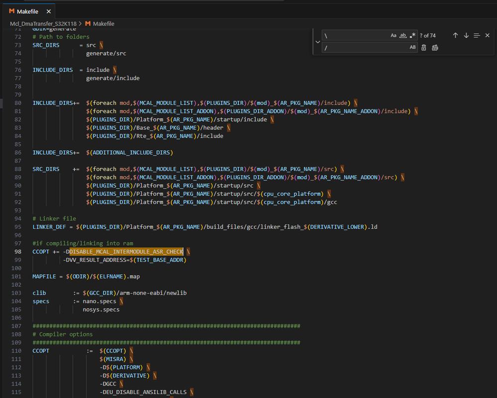

Hi Ahmed_Attia,
Could you check this part in makefile?
I see a define macro here, so the part that you mentioned will be not activated.
Please help me check this one.

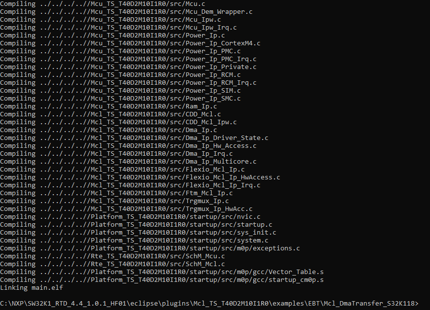

"Note: Please try to build your example and configuring the necessary modules again without integrating Lin module and I2C module the problem will produced from your side"
>> Have you tried to compile the example inside the RTD package?
I've tried MCL example for K118, obviously not any I2C or LIN modules.
I using same package as you: SW32K1_RTD_4.4_1.0.1_HF01
Could you help me to compile example in your side?

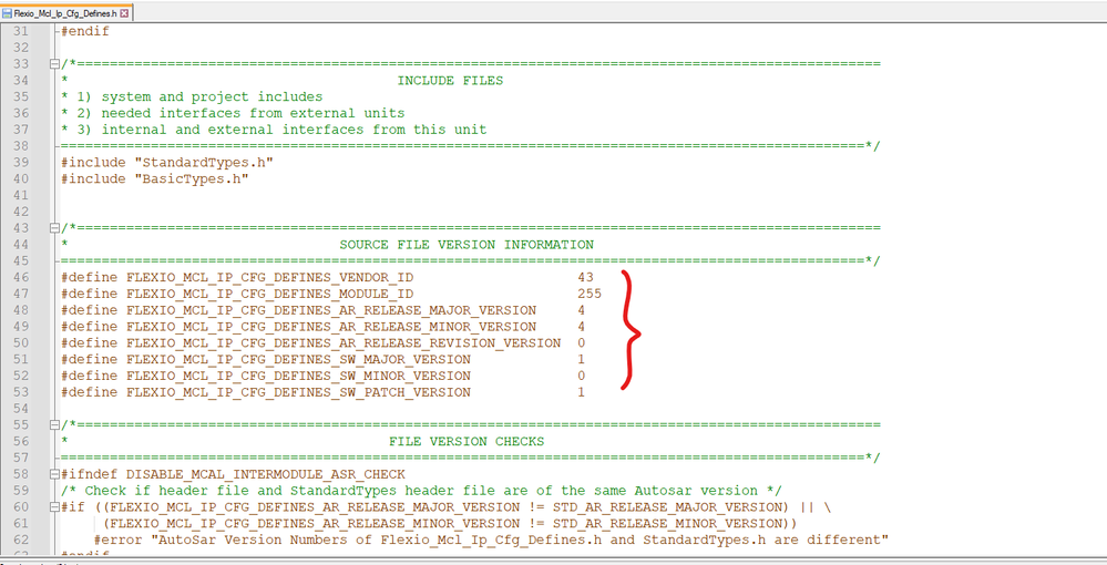

In the header files alway have information part guarantee about version/patch of the release package.
I think there're some mistakes when you adding new modules, or when you try to import files into projects. Could you please check the file: Flexio_Mcl_Ip_Cfg_Defines.h and share to me the source file version information part?

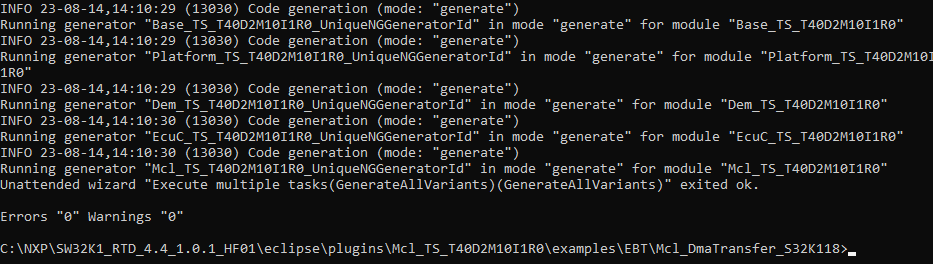

This below belongs to my example with generate and compile completely no problem:
generated_include_files.pnggenerated_include_files.pngtry_for_example.pngtry_for_example.png
